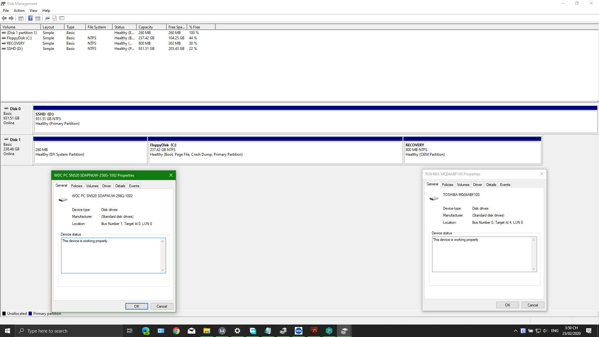

And yet it looks like you have an unsupported RAID. Please attach a screenshot of DiskManagement in Windows. And screenshot of disk “Properties” in DiskManagement
  • Author
Disk 0 is the Toshiba and Disk 1 is the WDC one.
You can try to change SATA mode in the BIOS from RAID (or RST) to AHCI mode. Probably after that Windows will stop loading! But KRD will be loaded. Restoring SATA mode should restore Windows.

The first method works for me, thanks for assisting!
