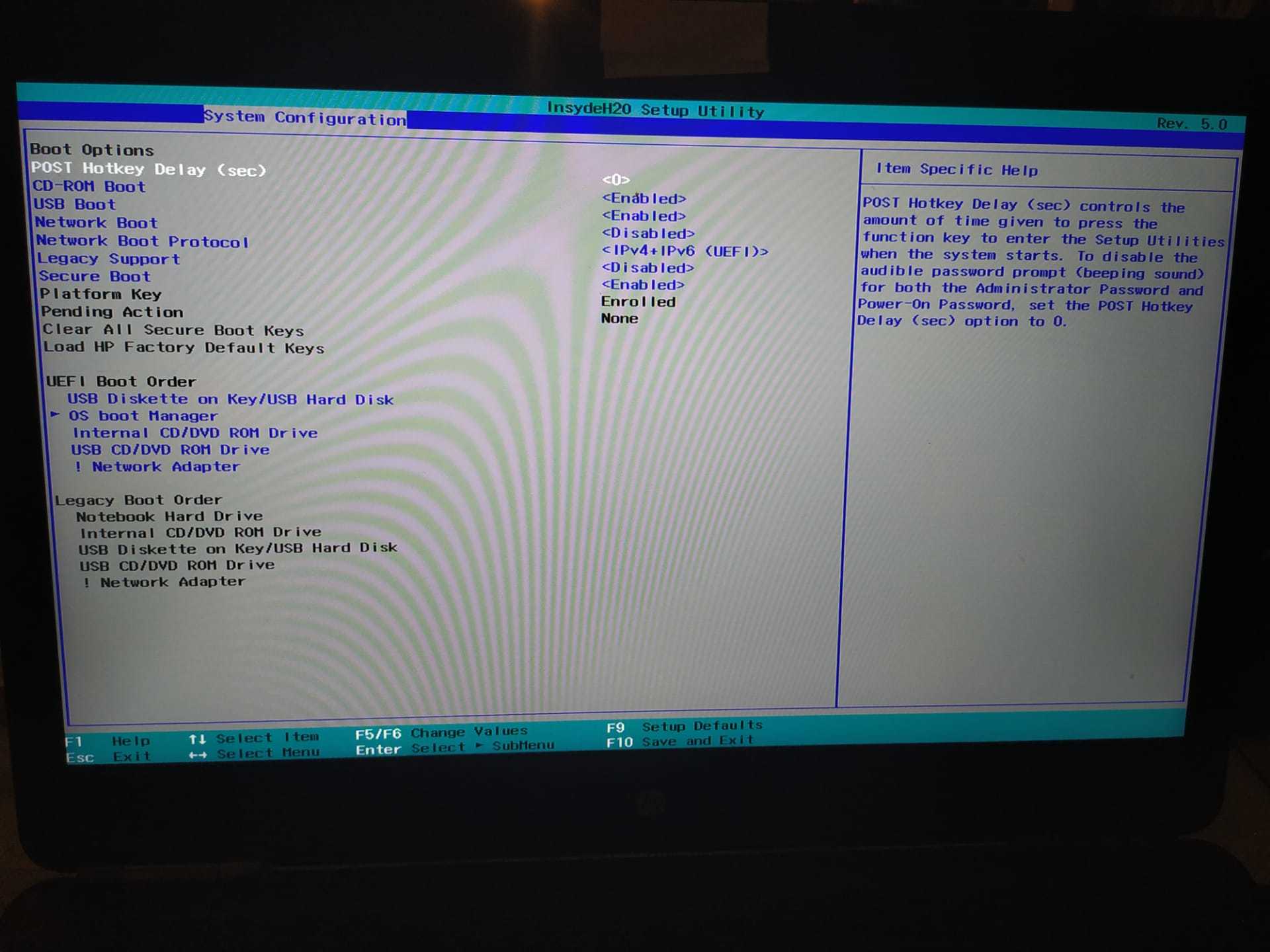

I have one option that is: “Definitions of UEFI firmware” where I can access to BIOS.  But then I don’t know how to “change the boot sequence”.
1. First of all, with “device that cannot boot into Windows” I think you mean an external disk where I will store my files? Or a CD  that arrived with pc? I don’t have any kind of CD or usb… If you meant  an external disc, should it be empty? Or can I have some files on it?
2. With “boot sequence” you mean “UEFI Boot Order”?

Hello @Bghit
Thank you for the image👌
  • Regarding other resources, you need USB flash drive with backup software & a bootable CD, USB, or DVD with an ISO, for Windows.
  1. Is (your) Windows licensed?
  2. Can you define exactly each step you are taking to get to the Setup utility screen?
  3. Can the Legacy Boot Order options be accessed?
  4. Is Hibernation enabled?
  5. Is Fast Boot enabled?
Please let us know?
Flood🐳

Hi!
As I understand you have renamaed the driver klbackupdisk.sys. Keep it renamed.
Next try to use KRD (https://support.kaspersky.com/14236) and locate the branch:  HKEY_LOCAL_MACHINE\System\CurrentControlSet\Control\Class\{71a27cdd-812a-11d0-bec7-08002be2092f}
There will Upperfilters paremeter . Remove from this parameter only klbackupdisk value.
Then try to boot the OS in Normal mode again .
